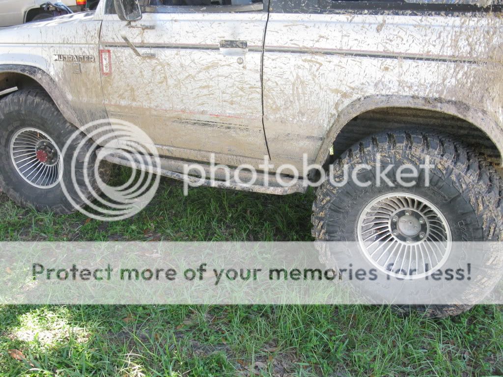

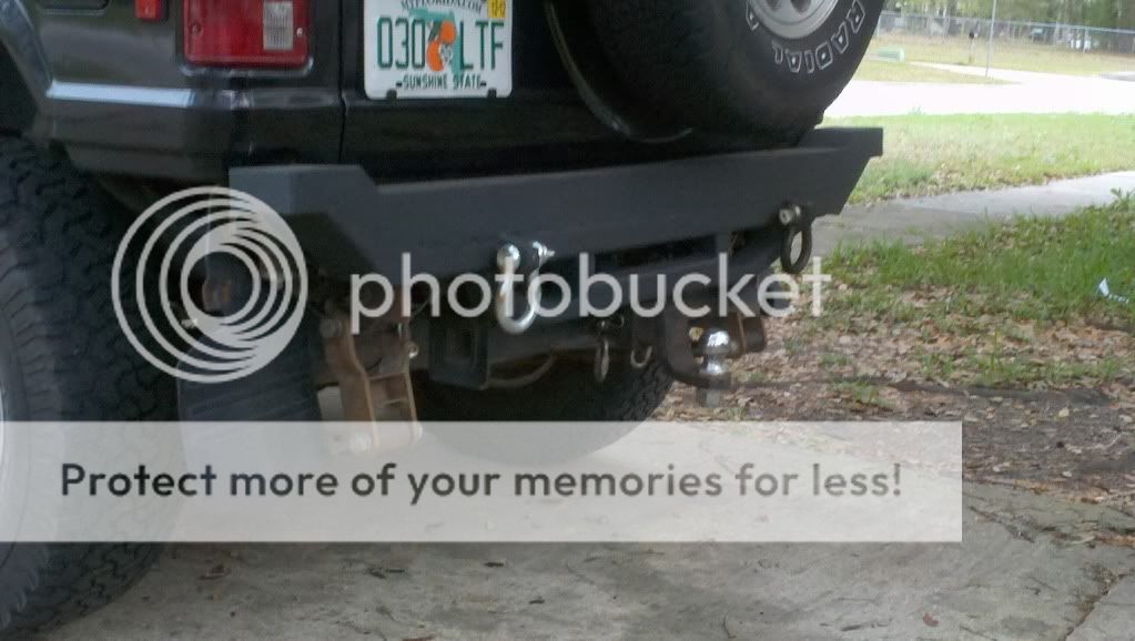

• Beg wife for inexpensive welder to build some bumpers & bull bars. Craigslist is your friend. $50 Miller Thunderbolt made these:
That’s what I got so far. I think I got it covered, unless you all can think of anything I am missing? Pictures of your ride, we all live vicariously thru everyone else's pics.
