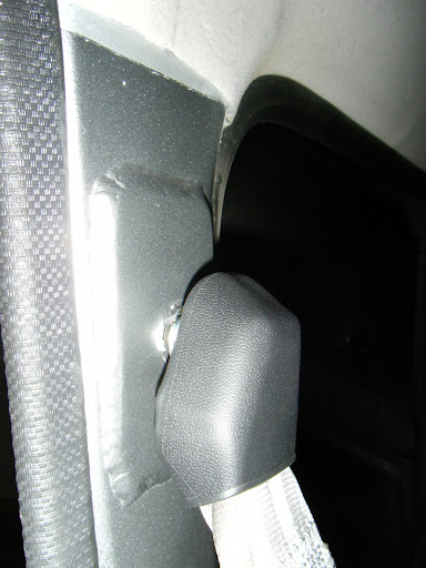

The other thing Don did for me was weld in a plate with a welded nut for the Toyota optional shoulder belts that I ordered a while ago. Now when the rear seat is in use, I have shoulder belts for the precious cargo that rides back there. Thanks again, Don!
