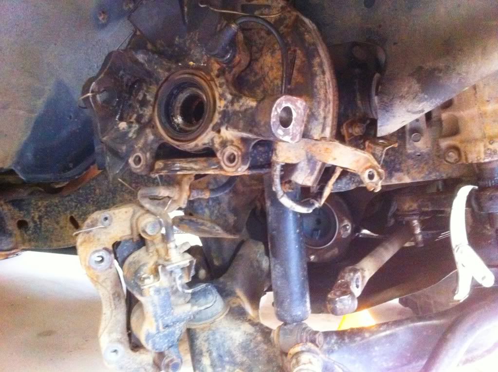

Started taking apart the front end yesterday, in anticipation of getting my parts today...
Separated the upper bj okay, had a bugger of a time with the lower one, and then separated the tierod, and pitman arm from the center link. But do you think I could get that @#$%^ pitman arm off the steering box? Argh. Put my puller on it, and whacked it quite a few times. Didn't budge...
I sprayed it with PB blaster, and walked away for a bit, had supper, came back - TWO SMACKS and off it came. Forgot how much I loved doing front suspension work.
Also have to replace the rh inner cv boot too. May as well do it all at once, eh? Sure hope those parts arrive today!!
