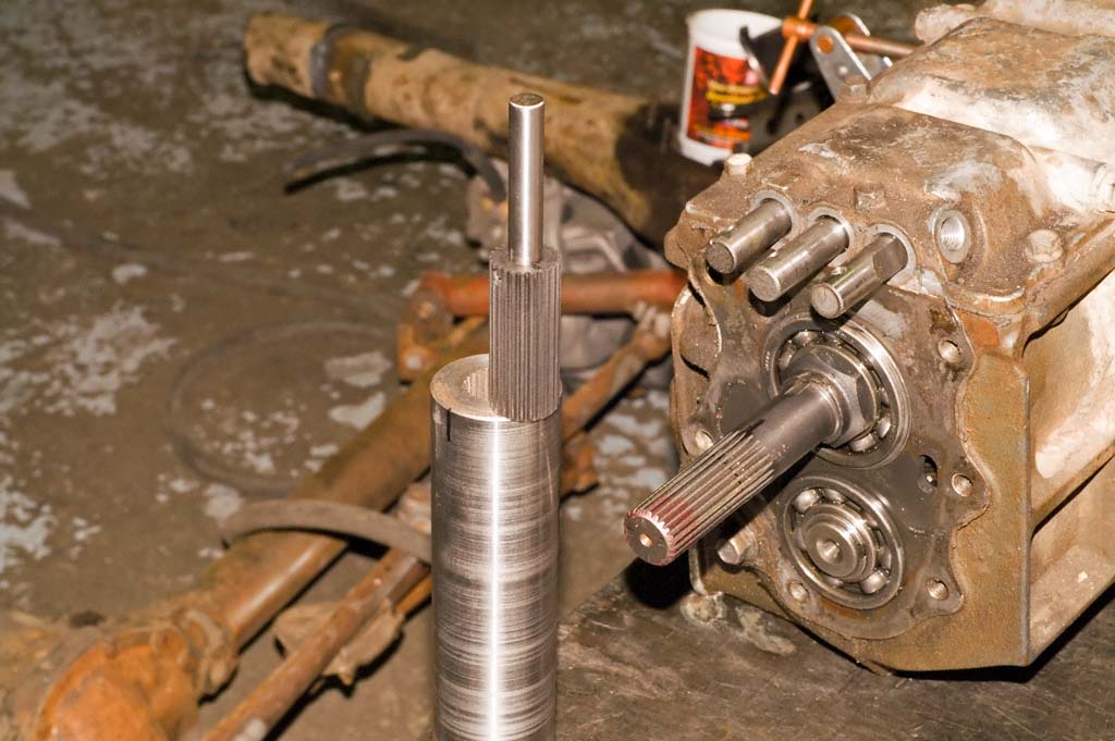

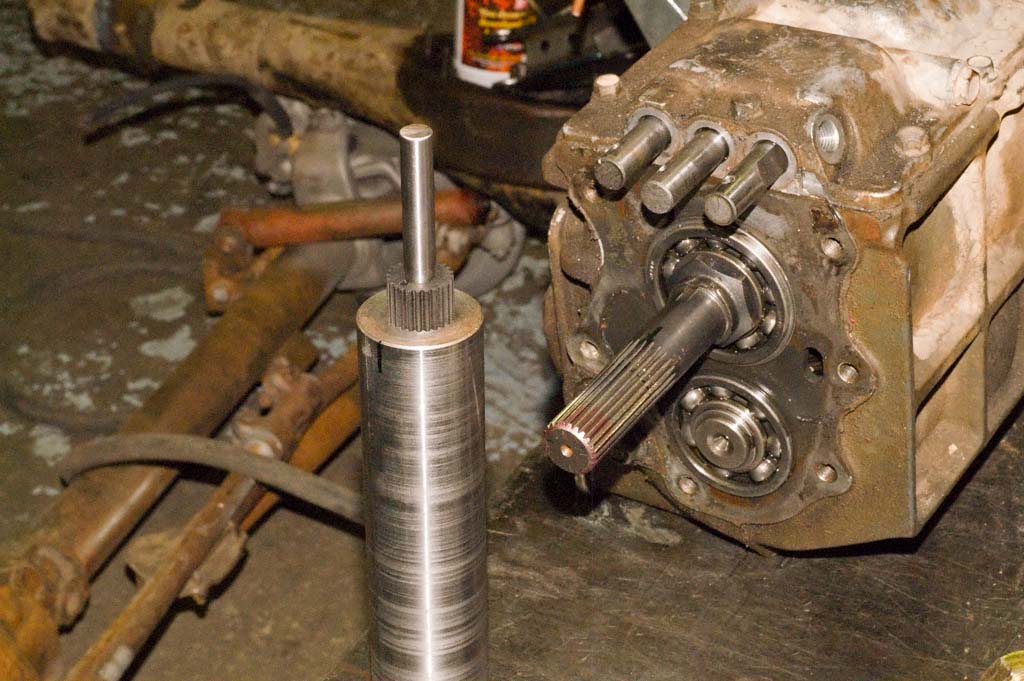

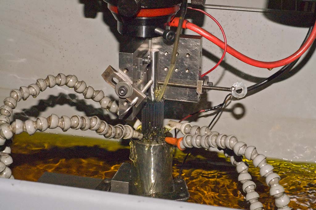

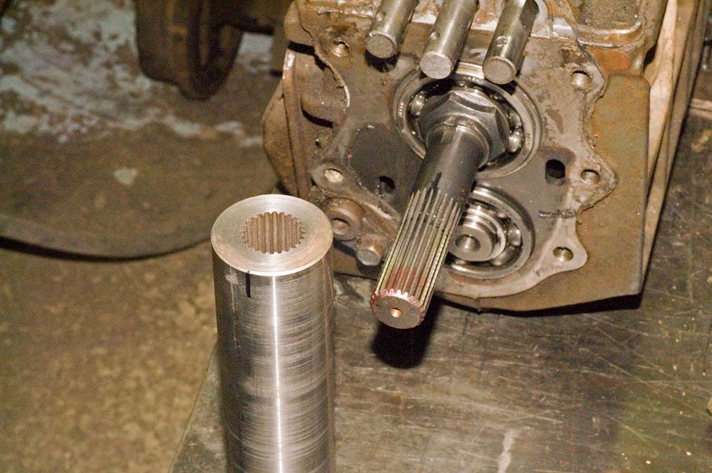

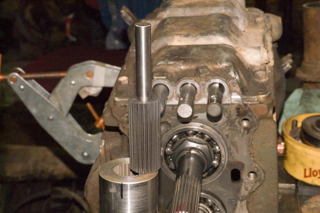

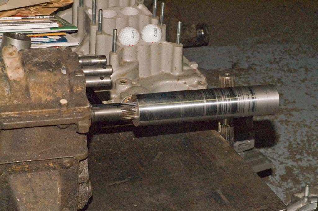

Yippie! They finally got the stub shaft from the transmission to the doubler EDM'd.
I also got tired of trying to find a low profile, alan wrench socket oil drain plug with an O-ring and a magnet. I finally ended up ordering a replacement from ARB for the lower drain plug in my new ARB Dana 44 differential covers. the plug was exactly what I was looking for. Installed it only sticks out about 4mm.
EDM maching doing it's thing
Fitted on the transmission
EDM electrode
EDM electrode in the stub shaft
Stub shaft splines and transmission output 1
Stub shaft splines and transmission output close-up
I guess the good part about this is if anyone needs a shaft to mate up to the V5MT1-3 output shaft these guys can now do that.
