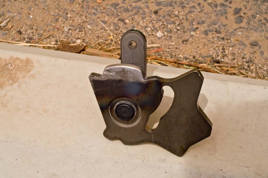

Looks like you had to countersink the shift rail bolt hole because of the extra mount you're adding. I had to countersink mine because I ditched the clocking ring and without it, there wasn't enough room for the fastener head.
I did take the time (I was bored) to have the shop weld up the two center divots (stops) in the doubler shifter mechanism - 4HI and N - and then I ground the weld down and polished it up nice. I figured that there wasn't much of a point to having stops in the shift sequence for something that doesn't exist anymore
So is Duffy not providing a new shaft anymore? I'm pretty sure my kit came with a new shaft with detents in the correct spots. Maybe not, it's been a while.
Correct. I could have 'sloted' the support but that was more trouble than it was worth.
Duffy still provides the shortened shaft. The detents that I eliminated are in the sector (shift) mechanism. That part Duffy's never supplied in the kits. I'll have to snap some pics and post 'em. Kinda hard to explain without a visual.
I think I remember you writing that you bought your kit from a third party, correct? You probably ended up with a sector modified by the guy that sold you the kit.
Welded up 4HI and N stops in the NP231 sector
