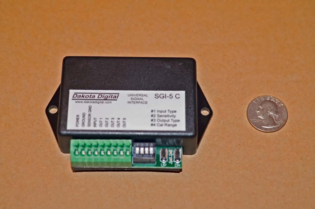

Finally got the Dakota Digital SGI-5 for the speedo conversion in the mail from Summit Racing. You can get them directly from Dakota but they were the same price and I like to support Summit when I can. Done a lot of business with them in race parts for a long time.
Dakota Digital SGI-5 C

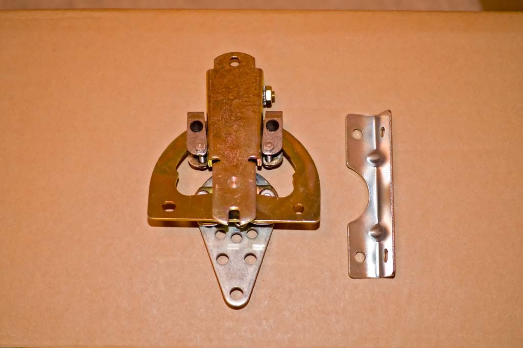

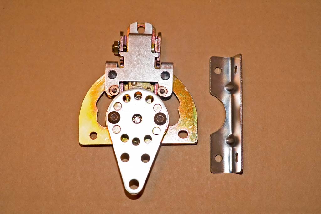

and the push-pull cable controler for the Tera Low231 t-case:
Push-pull cable controler (cable side)
Push-pull cable controler (handle side)
I forgot to get the name of the company in CA that produces the shifter. They actually have a couple different ones. I picked this one because I'm mounting it above the stock t-case shifter location and I need something that didn't stick down into the tunnel too far. I also didn't get a handle with the controller since I'm going to cannibalize the stock t-case shifter and stick it on the new controller. This controller has 3" travel and a 100" lb. rating which is plenty for the NP231. Be a good shifter for a Stak or Atlas if you wanted to mount them side by side. The controller is only about 1.25" wide. I also got this one because it has a clutch which is supposed to lock it in place. I'm hoping that will keep certain passengers from knocking the t-case out of gear. (don't ask, you don't want to know)
