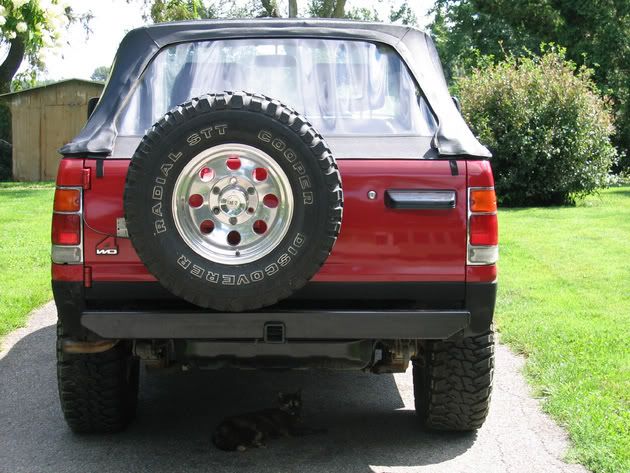

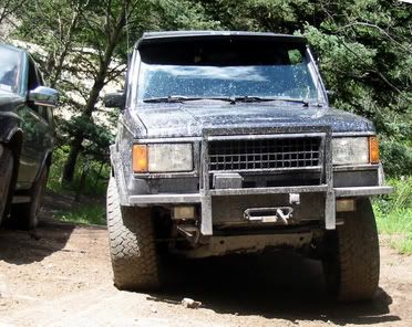

Re: Homemade Bumpers [Re: lucasgreff]
      #936102 - 11/01/06 09:13 PM
Simple rear bumper plumbed for onboard air. Nevermind the tires.
Semi-ugly front winch bumper, grill guard lifts out of 2 reciever hitches. Pre quarter panel bob.
Yup .... I'd do it somewhat different a second time.
Curt B 89RS Calmini Header Delta Cam 33x10.5 BFG MTs & 90 Trooper 3.4 v6, SAS D44 ARB/Hobart 5.38s 35s my pictures

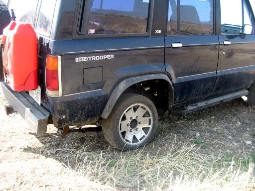

Re: Homemade Bumpers [Re: maxwell417]
      #936126 - 11/01/06 10:16 PM
Let try to keep this on-topic and save the banter for PM's.
Not a Trooper; but its a pretty generic design. I made the main body out of 2x4x3/16" tube, connecting pieces to the rear crossmember are 2x2x1/4" tube to 1/4" plate, and mounts to rear of frame are 3x3 angle iron.
Bumper:
Mounts on one side:
