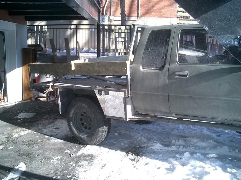

just checking in. i've been working a lot on the project over the last couple days full-time at my buddy's garage, trying to add all the finishing touches to the flat deck.
I'll let the photos do the talk.
My buddy's recent purchase: 90 x-cab + an EXPENSIVE pop-top roof tent!!! Did I mention expensive btw???
Me:

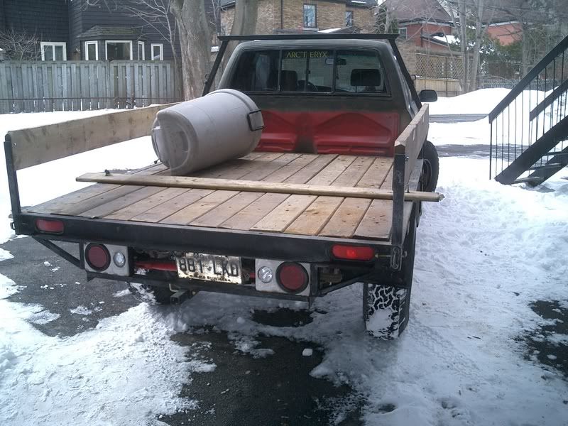

Rear bumper with hi-lift mount with full-size 33x9.5 spare:
Deck config.:
This is about a 800-900lbs load sitting on the deck. Ride height doesn't look too bad!

Lookin' good! You might want to pop by an RV or marine shop and get yourself a plastic top for protecting the battery posts from shorting on anything, provided you've got clearance. A thought.

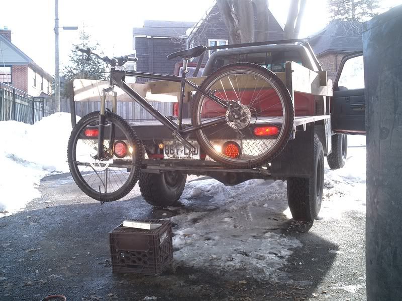

Got around to rivet the skins on today.
Passenger gas storage:
Driver-side straps storage:
Still figuring out how to make the rear milk crate slide-out sideway:

Progress today: a bike rack!
