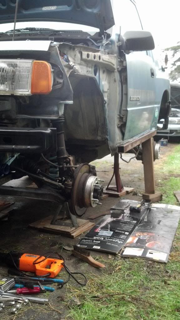

decided to replace the myside rocker area.
i saved the bracket patterns from the other side. this one should come out better........
progrep021913
it did go better, and got pretty much done before the weather moved in. i need to clean up my b/s/welds a little bit and add some more rattlepaint.
i think i gained a little more room in the front well, so i expect less rub.
mindchange022113
i decided to not irritate my wife w/the grinder noise. i put extra paint smoother on the welds.

rxinhed
The Mitsubishi Parts Guy
Reged: 02/21/05
Posts: 5899
Loc: Gerber, CA
Re: suzi the psychic [Re: rascott]
      #1275422 - 02/21/13 09:33 PM
Looks great! Was this easier than boat siding?
rascott
Reged: 05/10/07
Posts: 309
Loc: aptos, california
Re: suzi the psychic [Re: rxinhed]
      #1275486 - 02/23/13 11:34 AM
it could have been easier if i had a way of turning her upsidedown. that overhead welding while laying on the ground trying to see what i'm doing without cooking myself or doing major damage.........
the door still works, i may paint the other side to match.
i could use a hilift on both sides now(if i had one).
