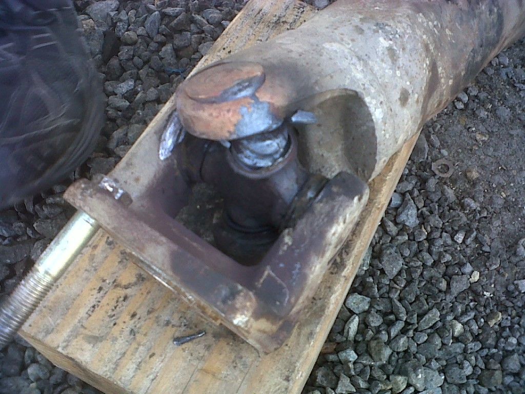

He'll post up some pics and specs but we woke up at 4am and 4:30am, PAJ picked me up at 5am, our flight took off at 7ish and we landed in Oakland around 9am. Ate breakfast with Cap510 and Grasscat, Loaded up and started toward Phoenix about noon.
Just into Bakersfield we were talking about how great time we were making and figuring we'd be in mesa just after midnight, as we were talking the rearmost U-joint overheated so bad that it started melting through the yoke (driveshaft side luckily), by the way this drive shaft had been crunched before and was out of balance and we opted to run it when we were at Cap510's house.
We got out to look at it and it was trashed, so we limped to the next exit at about 10-15mph hoping for a tool store or autoparts store, instead the first thing we saw was Flores automotive. They were open so we pulled in, they were too busy to help us until the next day, so they let us use their shop and do the work ourselves. We had to modify a spare that came with the truck, it had the yoke to the 9.5" rear axle and we needed to swap the 9" flange yoke from the junked shaft.
1.5 hours later we had a new balanced shaft, gave the mechanic a 10 dollar tip for letting us borrow his tools and shop and then he invited us to have dinner with the other mechanics and their family. Paj declined and said we needed to get back on the road and that we'd get food later, I on the other hand was hungry and not willing to pass up authentic Mexican carne asada with roasted jalapenos. So Paj had no choice but to enjoy a delicious dinner because i was already making us up a couple plates

Yes, it is a surviving isham truck. Dat's old sport is officially an AZ truck now. And yes quite the adventure. Here are some pics of the New AZ Crawler Crew member.
Here is the U-Joint from the driveshaft.
This truck has definitly been rocked before. I've been going over a few things on it and there alot of little things to fix on it nothing real major from the looks of it though. Need new motor mounts, tranny mount, new front shocks, new idler arm, possiblly some new ball joints and maybe bushings all up front, need to fix the A/C condenser do to a leak and thats all I could see for right now. Engine and tranny actually run really well everything felt really strong and shifts real nice. I will most likely replace all U-Joints also.

Wonder if there is a driveline angle problem with the lift? Maybe rear needs shimmed? Would not surprise me, I still have nightmares about that lift kit on the Fordyce Creek trail. Should be a fun rig once you get it dialed in though.

Drive line angle is fairly steep. At some point it wouldn't be a bad Idea to get a custom shaft built for it. It currently has a spacer between the driveshaft flange and the pinion flange to give it it's length back. The lift is actually pretty strong and for how much dat beat on it, it's still in fairly good condition other than the normal rock rash and dings. Luckily Dat was able to figure out the CV issue he had on the Sierra's trip after he got the lift installed.

It definitely needs the pinion angle adjusted, it's stupid that the shop that did the spring over didn't adjust it. The fab shop that worked on that truck did some really bad work, luckily it's not too bad to fix and neither is the lift *cough SAS cough.
