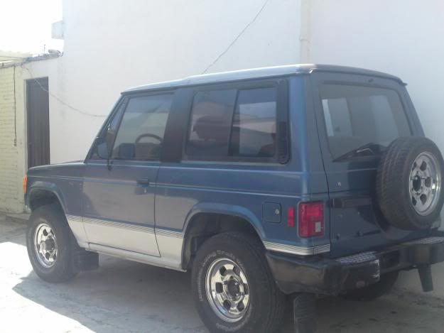

This is the guy in in question... for now
