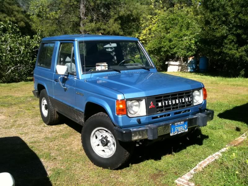

31x10.5s on stock rims:

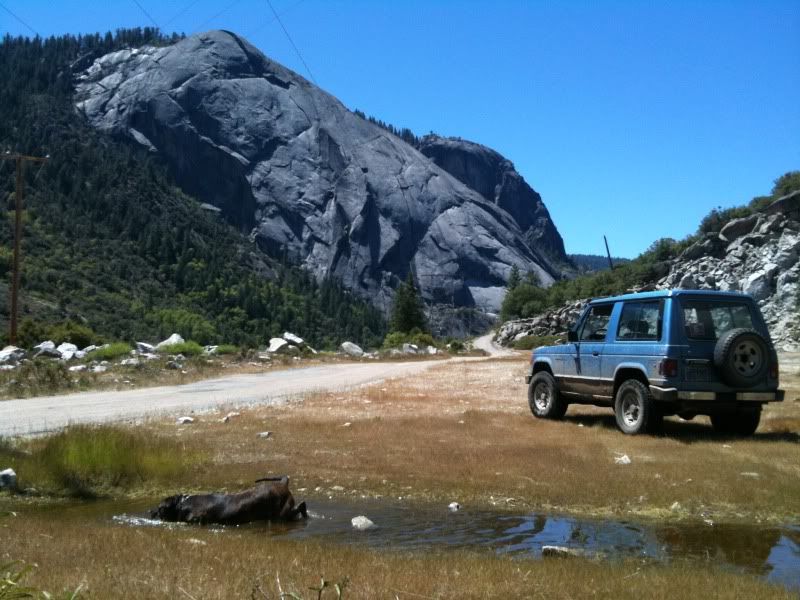

32x11.5s on Enkei 8.5" rims:

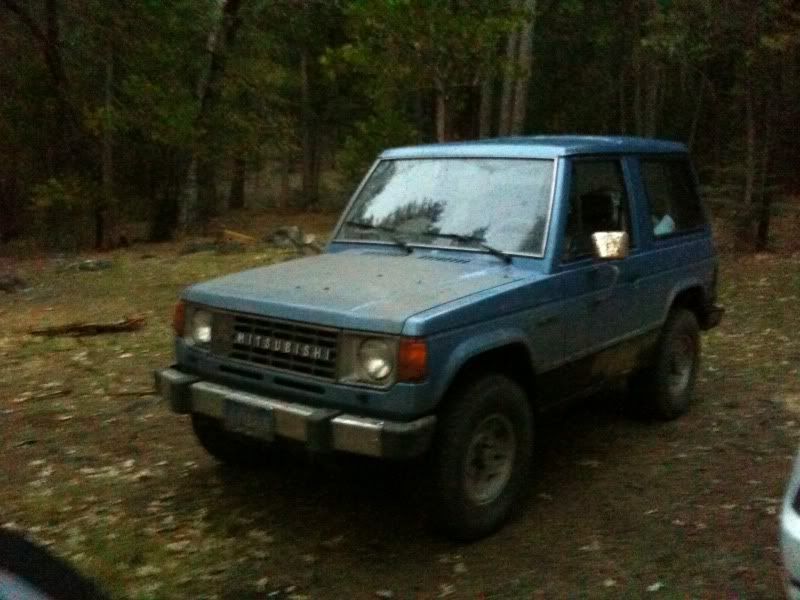

33x12.5s on 8.5" rims:
33x12.5s on 10" rims
All these photos have been paraded about in the past.
