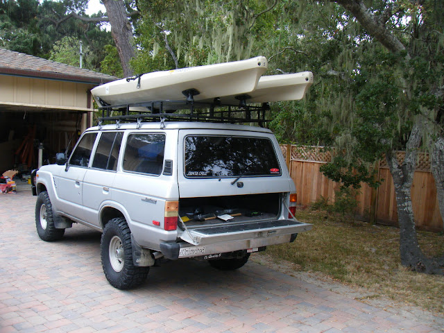

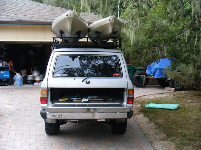

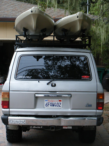

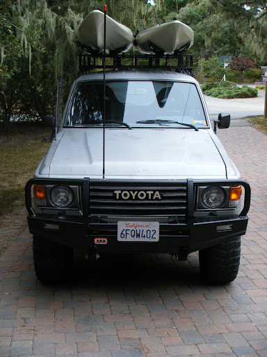

Thanks, Margie. I have 2 sets of yakima gutter feet and crossbars on the shelf in the garage. The reason they're not on the truck is because I have the roof rack that came on the rig. So, this weekend, I focused on getting the rack back on top, getting the kayak cradles mounted and test fitted, and getting the FTM-350 mounted up. I don't have any pics of the radio since I didn't get to work on my face plate mount, but below are a few pics of the exterior improvements.
I got the 33" X-Terrains mounted and installed a larger mirror on the driver's side. Once TLC gets another, I'll put one on the passenger's side, as well. The visibility improvement is amazing over the old one.
My helper...glad to finally see his kayak back on the rack. He's been dying to get back out on the water.

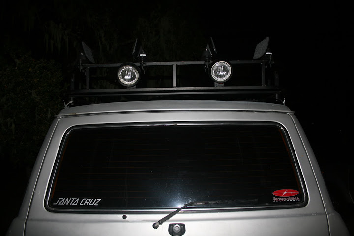

I went ahead and mounted some anti-tailgater/campsite lights on the rear of the roof rack. I should get them wired up tomorrow.

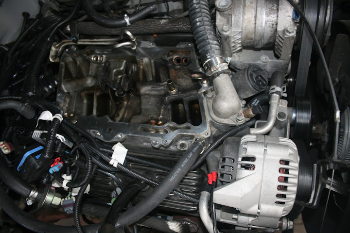

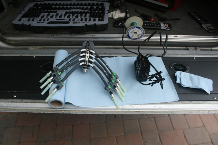

The V8 has been feeling a little sluggish under load, so I've been doing a lot of reading. During my digging, I found that GM put out a TSB on the fuel injectors on this engine. A quick call to my favorite parts guy revealed that he had everything I needed to do the update in stock, so I tackled that last night and today.
Old vs. new. The new setup is pretty cool. It didn't really help with the sluggishness, but it is good insurance and definitely worth the coin in cost to get the parts. Reliability is the word for me these days...
Inside the upper intake cover after I did some scraping and cleaning. The GM tech I was chatting with mentioned large amounts of carbon buildup in there when the engine hasn't been maintained religiously. Well, the front half of this thing had carbon caked in there. Scraping with a shop vac providing continuous suction took care of most of it. I will say that this engine is a dream to work on compared to the last two I've done work to. We'll see how things shape up after I put a few miles on it...
