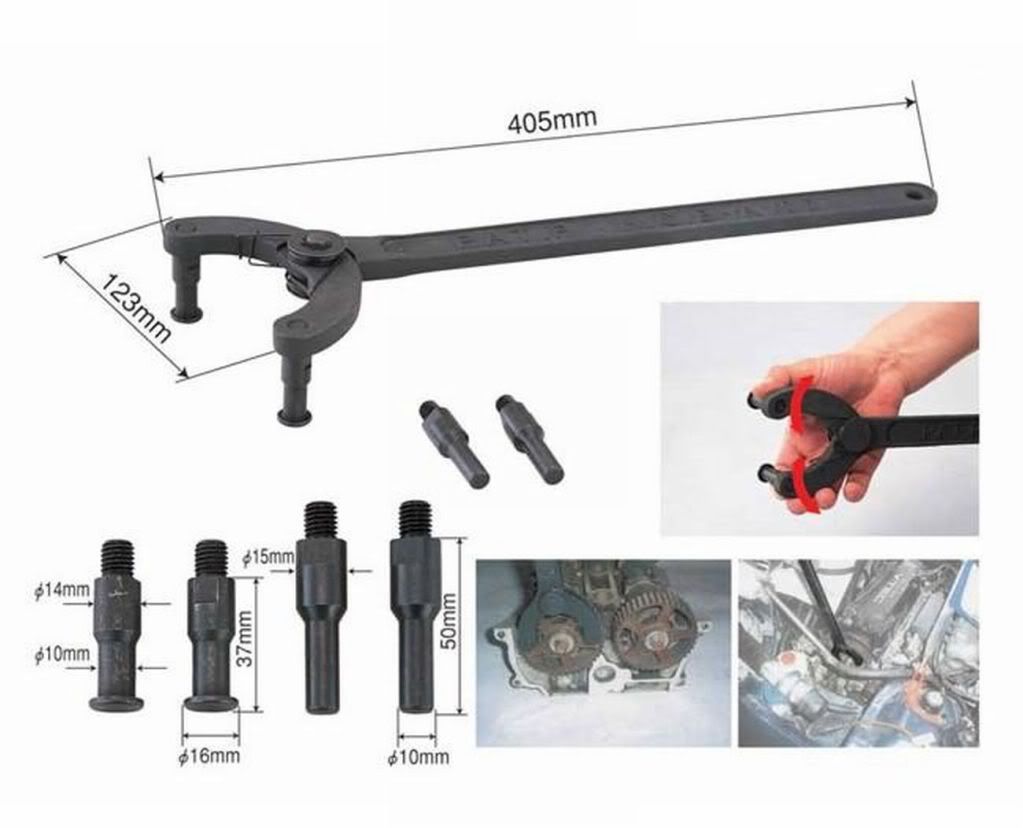

Here is the professionally made tool if you can find it.
Tool for holding the crankshaft pulley and holding the camshaft pulley.
No I do not know where to get it, sorry. :cry:

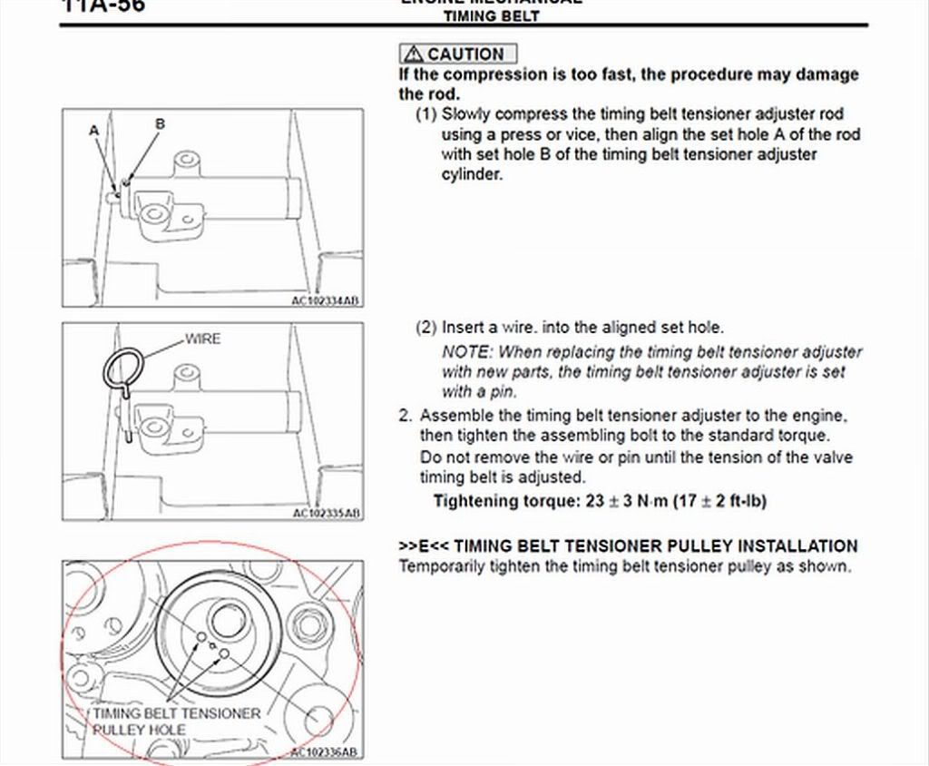

Here is you timing belt tensioner tool (find on ebay for less than $20)
Here's a How-to diagram for the tensioner.
