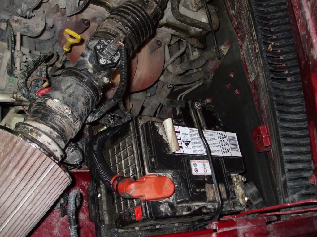

wellone and all here is the start of my turbo fit up.....
have been flat out at work and i havent done much....
and am still waitin for some more bits to arrive.....
first of all you need to make some ROOM for the the turbo.......
the battery in the oz ones sits right against the firewall on the left hand side of the engine bay.....to make romm(and a heap at that)..you need to relocate the battery longways so it sits against the left guard.......made a few brackets.....and mounted the battery tray like so and all you do is lengthen the positive cable ....used huge battery cable for good power supply .......seems to have made a difference to performance just by doin that ......but i dont think so....the battery was disconnected for a while and when i connected it , its goin heaps better .....so i think i cleared some gremlins hey.....haha..

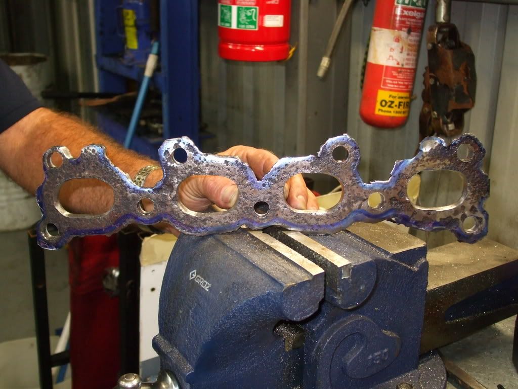

well......a little update guys.........have the flange plate ready for some pipes to be welded to it ....here is some before and after shots.......
