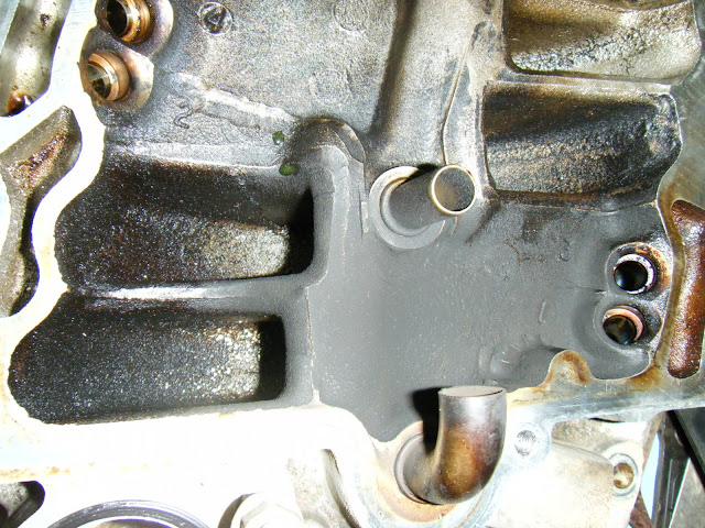

Head/Gasket/Block Pics
I'm trying to find a good deal on the 95-99 Vortec with all the smog stuff attached. I should be able to get one for under $1000. We'll see.
Today, I got the head off. I don't see any immediate signs of head/gasket failure. I just don't know...
All of these pairs of pictures show cylinders 1/2/3 in the first picture and 4/5/6 in the second.
Top of head gasket
Bottom of same
Head
Block

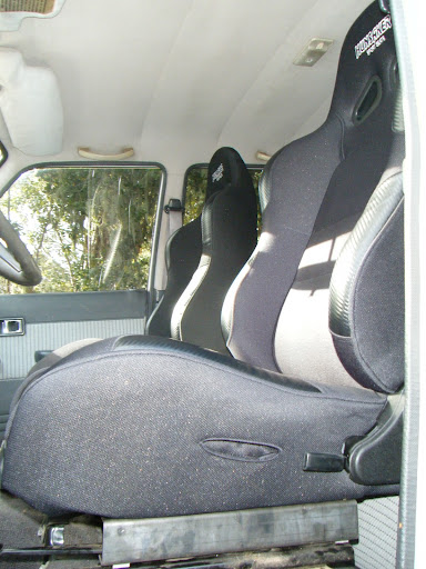

Interior Work

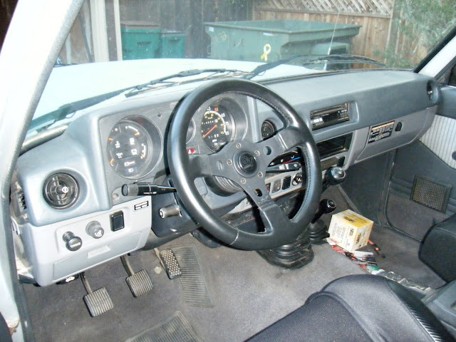

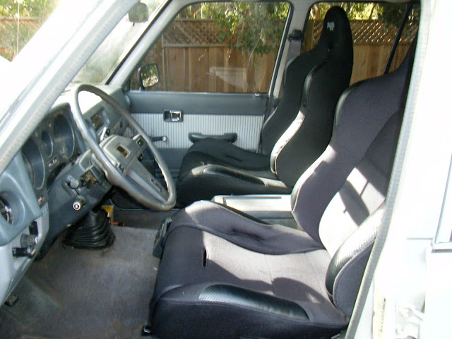

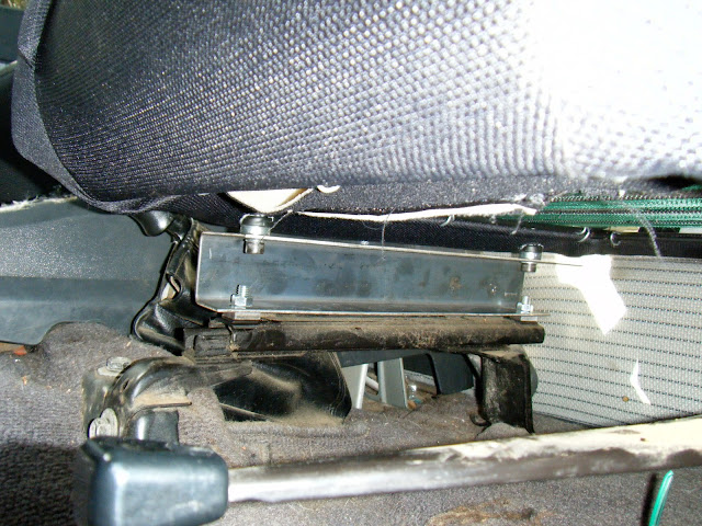

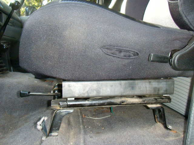

Once I got the head off, I couldn't do much else without making a big decision to take the plunge and pull the rest of the original engine out, so I decided to do some "fun" stuff. I had a set of Hunsaker seats and a Grant steering wheel, so I got busy putting them in.
I have very long legs for a 6' guy. I wasn't comfortable with the seats at the stock height, so I had some custom 2" brackets bent up at my favorite metal shop. I had some flat bar cut down and drilled as spacers so the factory sliders could work properly, and bolted everything to the factory mounting holes. I LOVE these seats and the revised seating position.
As for the steering wheel, I noticed that there was a good layer of crap on the original wheel while driving it home on the day I bought it. I wasn't to happy about grabbing on that all the time, and with the higher seat height, the original one was really close to my legs. I grabbed the Grant wheel off the shelf in my garage and put it in the Cruiser. I have GREAT gauge visibility with my seat height and think this will be a very comfortable driving configuration. I'm sure it may be a little tough to turn at a standstill once I put 33s on, but it'll be ok.
I purchased a Tuffy stereo security console from my local parts house and worked on getting it into position but ran out of time. I'll post pics of it in place once I get it in there. I will say that the top pad is at the perfect height for my arm to rest on and be ready to shift. I'm VERY happy with these upgrades as a whole.

Re: Head/Gasket/Block Pics
You should be able to get a vortec for that money. Around here I can get one for 600-800.
Is it just me, or are those cylinder holes in the head gasket ovalized very bad? Or did you bend the gasket in half after took it out?
(Roll Me Over)
06/02/10 01:11 PM
You know, Adam, I thought the shape was wierd, too. But, since they are ALL that way, I thought that it was a design thing? I didn't bend it.
EDIT: Looking at the combustion chambers on the head, the holes are supposed to be shaped that way.

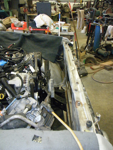

FINALLY, a little progress. I got the 2F out of the way today. The engine bay is pretty clean for an 87, but I'm going to get the unnecessary wiring stripped out and steam clean it and the undercarriage. It looks like the t-case will have to be split so the tail housing can be machined for a custom reluctor ring that needs to be added so the Vortec emissions system will function properly. Since the transmission is coming out, I'm thinking heavily about taking the plunge and adding an H55 gear box to the build. $2000, but WELL worth it for a 5 speed, I think. Thoughts?

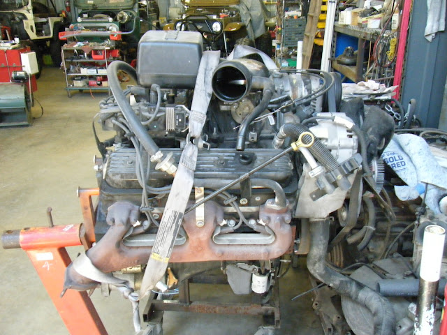

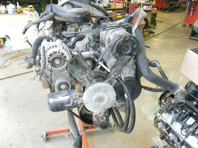

5.7 Vortec Pics
In with the "new"...

Well, over the last two days, a lot of work got done. Custom Cruisers, in Gilroy, is handling my fab work since I can't weld worth a flip. I wanted to use the stock Suburban exhaust manifolds for smog reasons, and this required mounting the engine 1/2" to the driver's side. Ron and John machined my transmission crossmember elongating the holes to shift the trans to driver by 1/2". A 1/2" (I think) spacer was made to move the P.S. pump to the outboard side to accommodate the engine. It was quite a bit of work, but it looks as if it will work well.
After the engine came back out, I replaced a bunch of parts for piece of mind on a 100k engine. I should start wiring and installing the OME lift early next week.

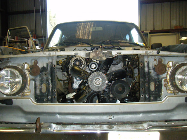

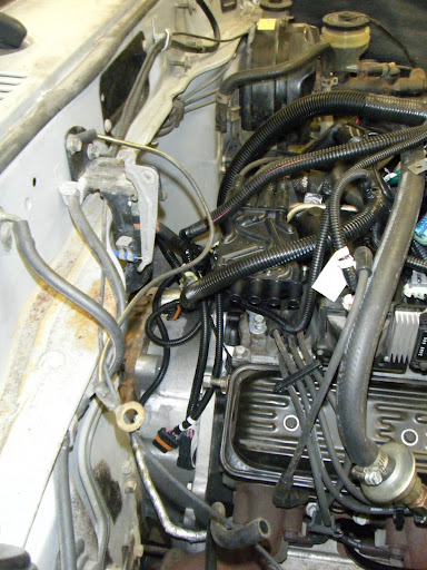

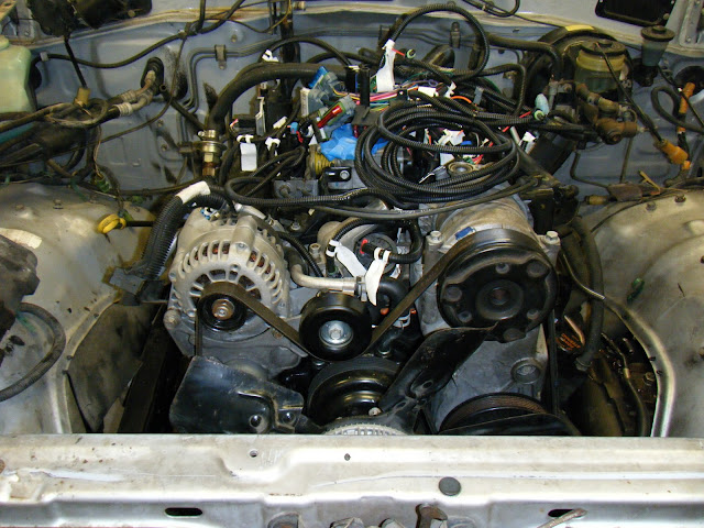

Today, I got to the shop early and got some work done. John put the flywheel on while I cleaned up the bellhousing and got some odds and ends going. Once the adapter, clutch and bellhousing was bolted up, we took a little time to check the engine bay one more time.
Here is the engine with all of it's necessary accessories
And with the Howell harness attached
And bolted in

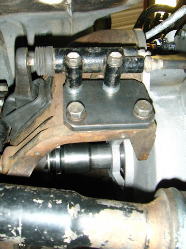

We pulled the transmission out to put in a twin stick kit in. Yeah for 2 Low!
Old
New

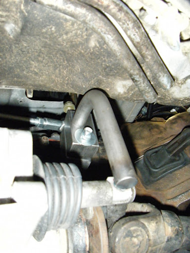

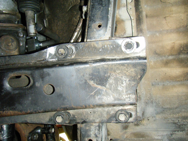

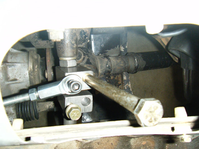

07/02/10 01:18 AM
Yesterday:

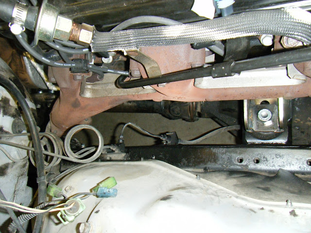

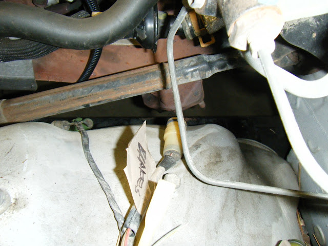

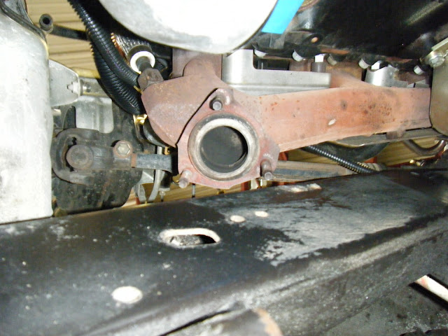

I went by the shop to see what Ron and John got done. The engine was in and hoist was away.
Here are a few shots of the clearance within the bay. The rear has LOTS of room with great access to normally hard to reach items for maintenance. The front is set up PERFECTLY for the custom radiator and shroud that Ron is making. The driver's side is the only potential tight spot with the exhaust clearance very tight. Ron assures me, however, that his exhaust guy has a lot of experience overcoming these issues.
Next are a couple of pics of the twin stick kit installed. The shifters still need to be formed, installed and welded, but the kit is pretty cool.

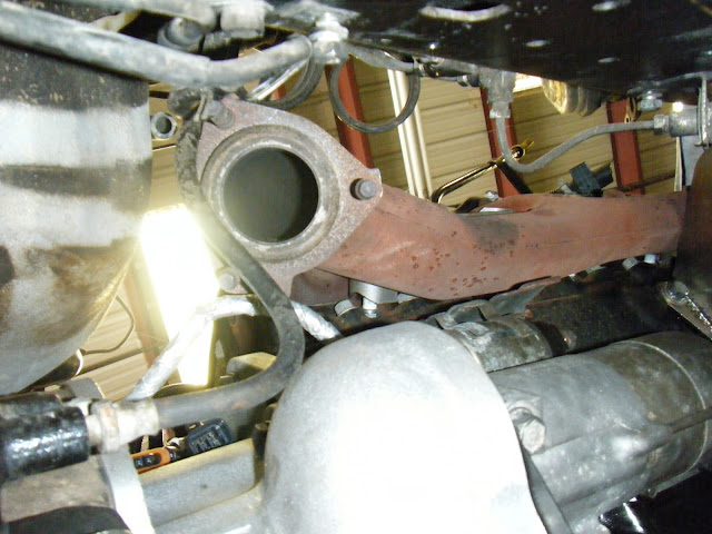

Pictures of the transmission modifications

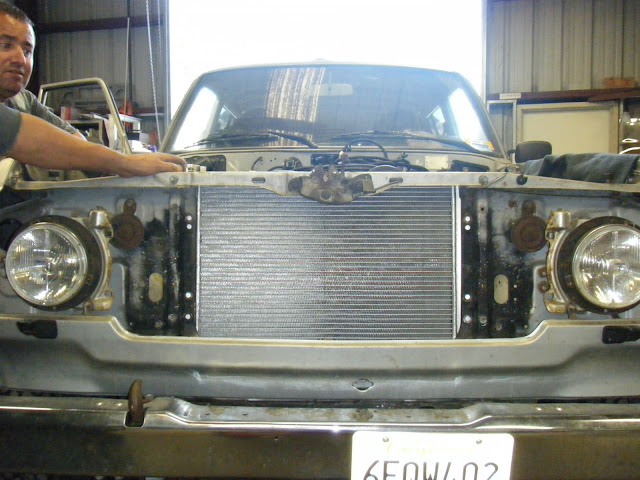

This last pic is a radiator similar to the one that will be built for mine. The one in the picture is for an FJ40, and mine will be 3" wider to maximize surface area in the available space.

My radiator also came in today, and Ron worked his magic. You can see the surface area of the cooling surface. This thing is PERFECT! The mounting is awesome, and solid as can be while still sitting on shock absorbing isolators.

Well, I'm a little late getting to this, but here are some pics for anyone watching...
The final engine pics. I loaned one of my batteries to someone, so I don't have the dual system completely wired, but the solenoid is in and ready to go. The fan shroud is a custom one made to go with the custom radiator. The radiator is installed as it came, straight off the shelf, so if the day comes that I need to replace it, I won't have to do any modification to the new one. The exhaust came out GREAT, and I'm perfectly happy with the tone and performance. NO droning with this Magnaflow...

The V8 has been feeling a little sluggish under load, so I've been doing a lot of reading. During my digging, I found that GM put out a TSB on the fuel injectors on this engine. A quick call to my favorite parts guy revealed that he had everything I needed to do the update in stock, so I tackled that last night and today.
Old vs. new. The new setup is pretty cool. It didn't really help with the sluggishness, but it is good insurance and definitely worth the coin in cost to get the parts. Reliability is the word for me these days...
Inside the upper intake cover after I did some scraping and cleaning. The GM tech I was chatting with mentioned large amounts of carbon buildup in there when the engine hasn't been maintained religiously. Well, the front half of this thing had carbon caked in there. Scraping with a shop vac providing continuous suction took care of most of it. I will say that this engine is a dream to work on compared to the last two I've done work to. We'll see how things shape up after I put a few miles on it...

Tomorrow, I'll install 4* shims to get my caster straightened out. Steering has been a little touchy since installing the OME lift. I also will finish installing my S/S brake lines from TLC 4x4 and the Russell speed bleeders that Margie and Brian recommended. Finally, I hope to get some wiring done on my various lights and interior stuff. I have an ARB fridge to figure out mounting for and need to get packed for next weekend. My stuff has cobwebs and dirt (not dust) on it from sitting in the garage...

This weekend, I flogged on this dolphin quite a bit but didn't quite get the thing straightened out. I'm trying to get a new MAF for it tomorrow. The saga continues...

Finally, I've been on the waiting list at Lavender Bros Automotive (XXX Traction) to get some rocker protection fab work done. These sliders are one off and BEEF. Toby designed them to sandwich the crease between two tubes. We discussed notching the seam to allow them to tuck up close to the body and decrease ground clearance reduction. I brought them home to clean and paint them today, and Toby will install them on Monday.
Sliders
Notches
One more for scale
It's almost ready to wheel. I'm looking forward to getting out on the trail!

I also have been trying to figure out why I have popping through the exhaust on deceleration. When working with Howell on a replacement computer, I realized that my manual transmission Express van profile does not have a provision for the AIR injection pump that was plumbed into my rig. I made some block off plates for the manifolds and installed them with GM gaskets. A trip around the block had the rig running a little better, yet, and with no popping. I'll give it a test on the hills to see if it really is better tomorrow.
When removing the AIR flanges from the manifolds, I noticed a fuel smell. I wonder if the O2 sensors weren't getting a jacked up reading with fresh air from the pipe being allowed into the system at the manifold. Maybe it's been running rich on account of this. Hopefully, I haven't put enough rich running time on the new cats to jack them up, too.
I went on to replace the driver's side window regulator, replace a jacked up t-case dfill plug, replace a jacked up tail light lens, change the oil, add a grab handle over the driver's door...little stuff that just needed to be done. I ordered a set of OEM non-retractable shoulder harnesses for the back seat. My kid deserves them.

The AIR system is getting jettisoned. I'll get around to procuring some proper AIR-free manifolds at some point, but the block-off plates will suffice for now.

I cut the damaged rear bumper crossmember out on Thursday and need to try and get the rivets drilled out to remove the end pieces.
Today, I picked up an H55F (5 speed) to put in place of the H42 (4 speed) that the U.S. version Cruisers got. I'm going to reseal it, put bolt up the spare t-case that I got with it, and try to get it installed before my drive to see the family in Oklahoma at Christmas. Next Saturday, I'm going to pick up a knuckle rebuild kit, wheel bearings and the t-case rebuild kit/transmission seals. I've got quite a bit of work to do, but I want to get all the stuff collected before I start taking the truck down. I have new front brakes sitting on the shelf for when I get the rest of the parts.
Once these last few maintance items are taken care of, I will have been through everything with the fine-toothed comb and should be able to trust it on a real trip. I still have to try to figure out cruise control for the V8. That's the next research item on the list.

Bottom Line Up Front: Don@FC Fab is a metal master, and if you want to REALLY improve your rig, properly install your seats!
Anyone who knows Don, or has seen his work, knows that I've stated the obvious, but If you want to know why I'm posting about it, read on about my seat bracket...
One word on the impact of a seemingly insignificant modification...un-freaking-believable!
A little history:
When I bought my FJ60, I thought the seats were the most uncomfortable that I'd encountered in a rig during my 5 hour drive home from the purchase. I have long legs, so I had some "risers" bent at a sheet metal shop and installed them between the factory sliders and my Hunsaker Synkro seats. While I was instantly satisfied by the chair-like seating position, I didn't like the flat seat profile. I also didn't like the fact that my head was in the headliner or the fact that I had to crane my neck down to see stoplights.
Enter my visit to Valley Hybrids to get an un-named hippie to do some work on my junk. I interrupted Don while he was busy at work on the Crop Duster to talk about the art he was making on the thing. I explained that I was interested in his making me a seat frame that would:
1) bolt to the existing mount points in the 60
2) have a tilted base for my seating comfort
3) accommodate 5 point harnesses
4) accommodate my beloved Tuffy console
Well, the below pictures are what Don came up with, and the 2.5 hour drive home allowed me to discover that it is EXACTLY what this rig needed. It rounded out the package, and I can't wait until the next time I get to drive it.
My first impressions:
I was previously disappointed in my OME springs because I felt there was too much roll when taking long curves at highway speeds. Boy, was my disappointment misplaced! Some things happened when Don and I installed this bracket. Don mentioned that it may reinforce the body, and he couldn't have been more right. I was able to hold speed through corners, on the way home, that I always felt real uncomfortable with before tonight.
Sitting IN a seat is completely different than sitting ON a seat. I previously stated that I "loved" these seats. What I felt before pales in comparison to how I feel about them now. When a seat is sturdily mounted with the base at the proper angle, it keeps you planted and ergonomically correct. Now I know why real sports cars mount the seats the way they do!
If any of you have the opportunity to take on this upgrade to your rig, do it! I would put proper seating right up there with proper headlights with regard to drivability. Thanks for enduring my rambling, now here are some pics.

Don@FC Fab, on the other hand, worked more metal magic on the Wag. When he build my seat pan, he integrated a tab on the pan behind the seat for the shoulder harnesses to temporarily bolt to. He said he didn't like the angle of the belts pulling on my shoulders, so I asked about the possibility of making a removable harness bar that I can use while off-road with my kid, but that we can still use the rear seat for passenger duty on the road. He gave me exactly that.
As you can see, the bar bolts into the location of the brackets that lock the rear seat back into place. Don welded a scab plate in and added a third threaded hole for the bar. To use the bar, I just fold down the rear seat, remove the factory brackets and bolt in the harness bar. With the bar removed, I can put the factory brackets back in and use the rear seat as normal. When the bar is in place, it really stiffens up the body, and I like it A LOT.
The other thing Don did for me was weld in a plate with a welded nut for the Toyota optional shoulder belts that I ordered a while ago. Now when the rear seat is in use, I have shoulder belts for the precious cargo that rides back there. Thanks again, Don!
The last thing we talked about at length during my visit was topping and caging this thing. Damn, I'm on the edge and slipping...:D

but I decided to get off my dead ass and get the heads off the Vortec. As mentioned before, I dropped compression in cylinder #4. Here's why...
Nasty cylinder head...
Really nasty intake manifold. I found that the metal Felpro gaskets were installed, so the intake manifold has been off before. I have no way of knowing if the heads were reconditioned or not.
I can't understand why the front half of the intake is so caked with [censored]! I did notice that there were flakes caked in what I assume to be sticky oil from the K&N filter. I can't think of anything else that would be gummy like that. The flakes are from when I tried to clean my MAF sensor and it let go.
Front half
Back half
What an FJ60/Vortec engine bay looks like with the monster top end of the Vortec removed. That's a lot of stuff! I'm thinking of re-positioning my ECU using the bracket that Elbert posted a GM part number for.

Finally, Don (FC Fab) made me some beefy brackets for the 62 sway bar I want to mount. They are perfect, but my tailpipe is in the way so I'll be hacking that off soon.
I'll be getting my HAM and CB operational, sway bar mounted, and a few more things before the drive, but I'm happy with where I am for now.
