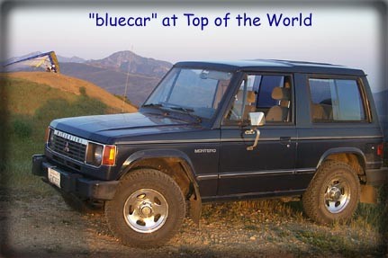

My 87 2.6 Auto which my dad now has, nicknamed "bluecar"
